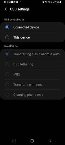

when I plug the USB into my USB-c adapter the system does trigger the USB Notification and if I click on it I get back the following screen
However I can’t really change anything in order to try other modes
I even tried to switch plane mode and so on but I am stuck there not being able to select any other mode and neither access 192.168.51.1
