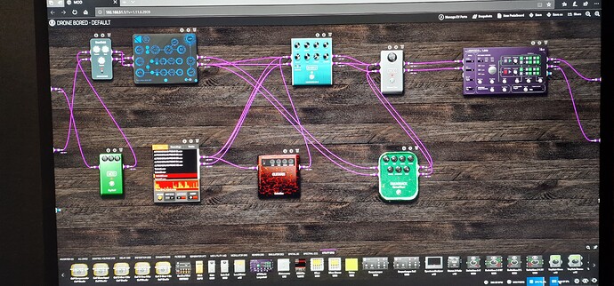

I was trying to create/ post a more streamlined board for you to try, when I tried something slightly different .
On the drum loops I have a parallel drive feeding into reverb which actually gives quite a nice undertone wash if that makes sense, that you can kick in and out.
It’s quite a boring board but will get you there , or out there if required. You then add stuff , needs a pitch shifter,  slow gear or volume swell, maybe a sequencer but you get the idea .
