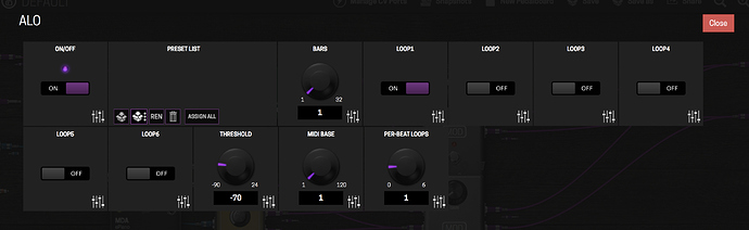

Woohoo this is now merged and live in the beta store! The updated ALO now allows start/stop loops at the next beat, and ignores small tempo fluctuations with external midi sync
I’m assuming that if i have signal going in, and with these settings, I turn on Loop1 i should hear a looping?
the only thing that seems like it works is the on/off button.
Ok for some reason now it works, thanks for getting back to me!
