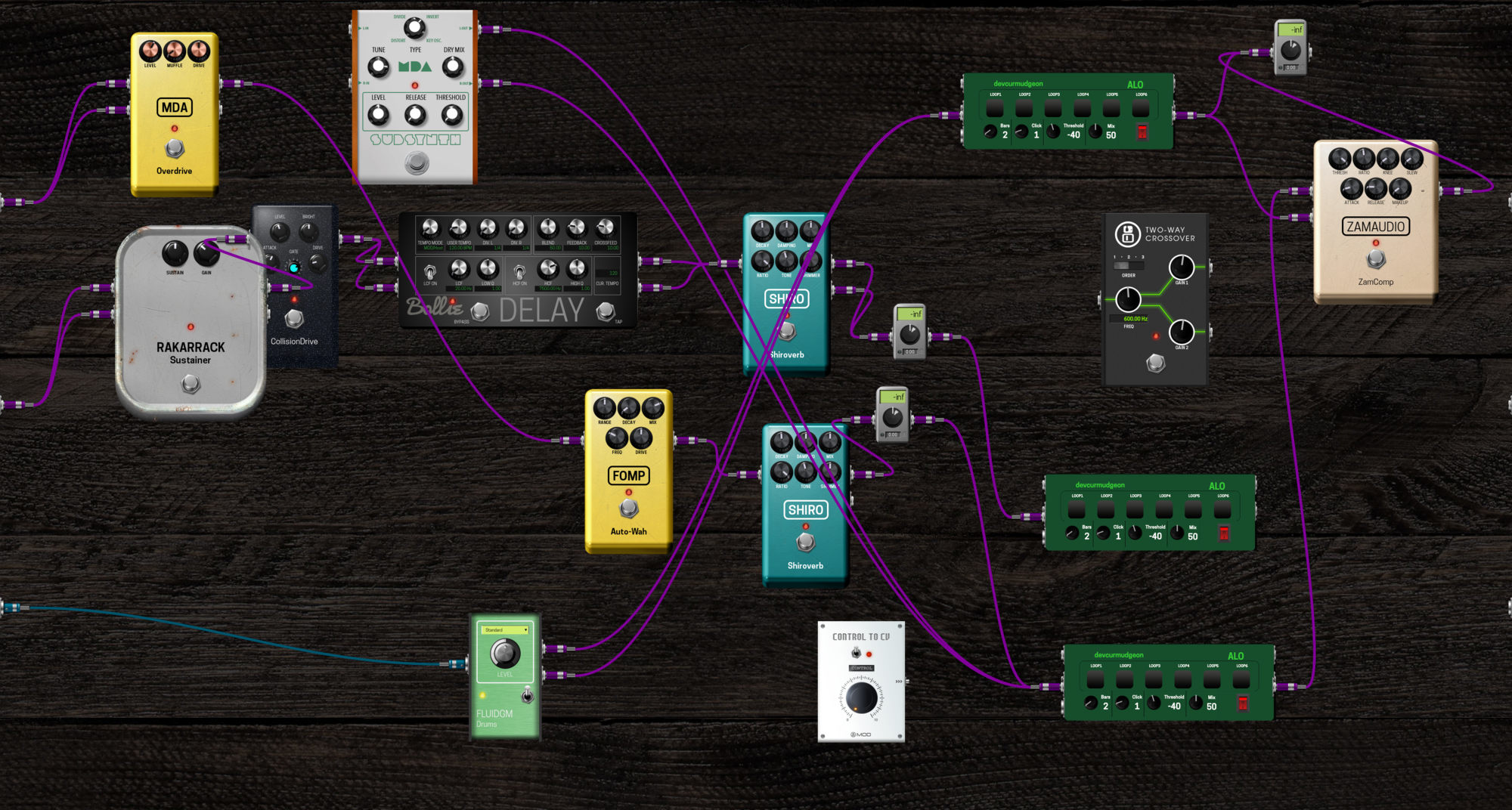

A number of my pedalboards uses the ALO Looper quite heavily. On some boards I have three instances of it. This has historically worked well, but recently I seem to be getting a number of crashes as the memory use goes up and up after every reopening of a board containing such loopers.
For example, using the board (and this being the current board in the system after power is attached to the mod dwarf)

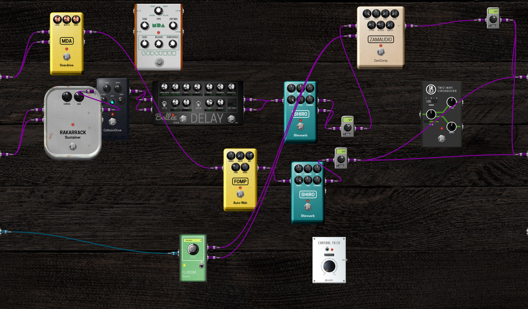

Now choosing a virtually identical board (except no ALO Loopers)
Nothing changed (whatever seems to have been in memory is still in memory)

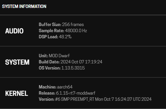

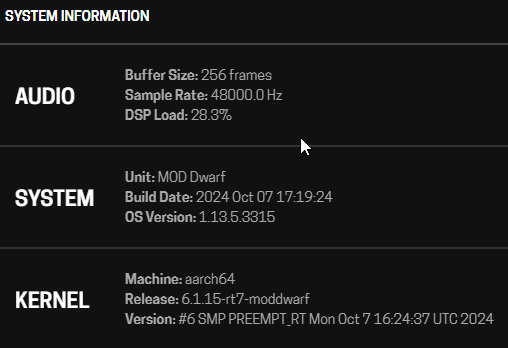

What might complicate this is that I bought a second-hand mod to complement my existing unit, and have done the “Reboot and Update” process a few times between them. Possibly the first time I did that (around April time) I began to notice more frequent crashes (although this has gone together with me making ever more complicated pedalboards and so could be just coincidence)
This is the details of the second board, which seem identical (just dsp load higher because of different pedalboard)
