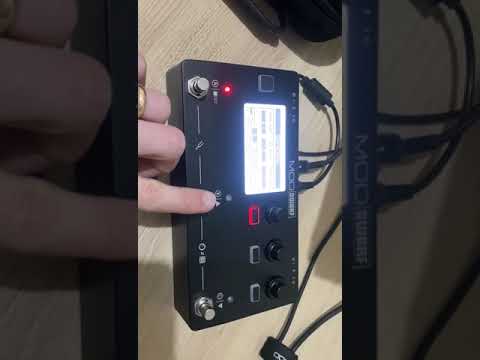

All leds light off when the UI shows an alert (like pressing switch on an effect) and press quick menu button.
How to reproduce
  1. Press a footswitch for shows a UI alert;
  2. Before the alert disappears, press the quick menu button;
  3. Notice that the ui alert will disapears, but the quick menu will not appears. Also, all leds will be turned off while you don’t press the quick menu button again

Hey SrMouraSilva, I have tested this and am able to reproduce it so I will make a ticket for this. Thanks for the heads up and the clear video showing the issue! :slight_smile:
