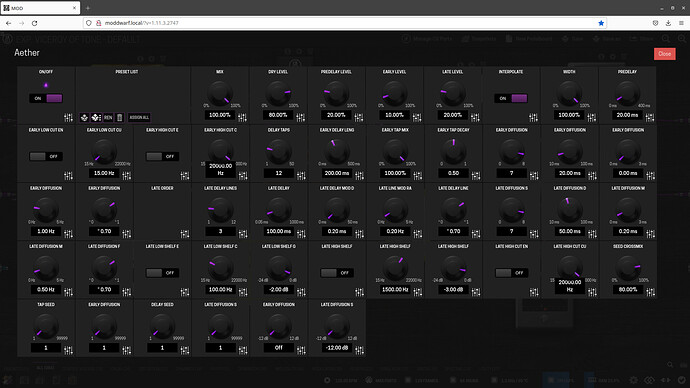

I just built it using the .mk file provided by the dev and pushed it to my Dwarf. Sounds really, really good. With controls in the default positions, it has a spring reverb feel to it.

some good news: I added Aether to another pedalboard that was already at ~53% CPU and adding Aether only bumped it up to ~63%. Not bad at all!
Sounds promising :slight_smile:
how many delay lines did you use?
If I’m reading it correctly, 3. I just left everything at the defaults. I will say that making a UI for this will be a challenge.

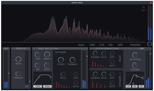

if we stay away from the foot pedal style the original gui would’nt be hard to implement - minus the graphical eq.
