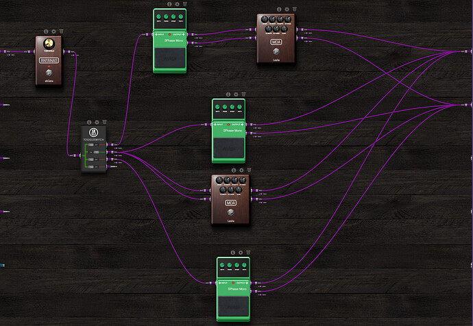

I’ve added MDA Leslie between compressor and eq and even if MDA is turned off, the global volume is higher than when no MDA is present into pedalboard. Is it an expected behavior?
This happens with GXCabinet too. At least, it changes the tone even when turned off. Are the plugins “true bypass”?
I put it in the list
I mean that with all Leslie turned off, result should be the same for all switches but it isn’t. A and C switch sound equal while B it’s different. Sounds at higher volume. Am I wrong?

We know that there are a few plugins with this behavior on the Dwarf (not on the others). It’s already being investigated and fixed in some cases, so no need to go into anyone’s list I guess.
This is a problem on the Dwarf somehow similar to what was happening with the CAPS AMP VST that was cutting the sound when placed on the pedalboard. As far as I know, that is already fixed.
The Dwarf is spreading its spells around some of the platform plugins, but we are getting the antidotes
