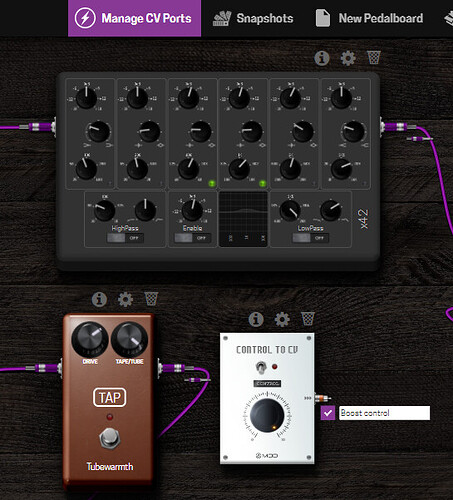

Apologies for raising an old thread from the dead - I found this thread via the search function so thought I’d add my solution for anyone else searching for the same thing.
You can use CV plugins to pass a single device control to multiple plugin parameters. For example, I have a pedal board with two independent signal paths. Both paths have a solo boost - Path 1 creates this with the x42 Parametric EQ, while channel 2 uses the TAP Tubewarmth plugin. I wanted a single footswitch to toggle both plugins on/off at the same time. To get this I did the following:
- Add a Control to CV plugin and turn its control value all the way up to 10v
- In its settings, assign the plugin On/Off parameter to the footswitch (leave the Control parameter unassigned)
- Back on the pedal board, click “Manage CV Ports” and check the box that appears next to the CV plugin’s output (you can also rename it to something appropriate if you want)
- On each plugin you want to toggle, assign the On/Off parameter to CV and choose the CV port you just created from the dropdown.
Now the CV plugin outputs 10 volts when turned on, 0v when off. The CV port assignment passes this through to the On/Off parameter of each plugin so one switch controls them both.

Snapshots/presets didn’t work for me in this case because they would recall the states of other plugins on the board. E.g. there’s an amp simulator on the second signal path - let’s say I’ve tweaked the EQ on that, if I used a snapshot to switch on the solo boost, it would reset the EQ at the same time.
This way, I can kick the solo boost on and off without affecting the other plugins.

I can’t share my first board as it contains paid-for IRs, so to demo the CV control I put together another one that uses only free plugins: 2-Channel Guitar Rig - MOD Devices
