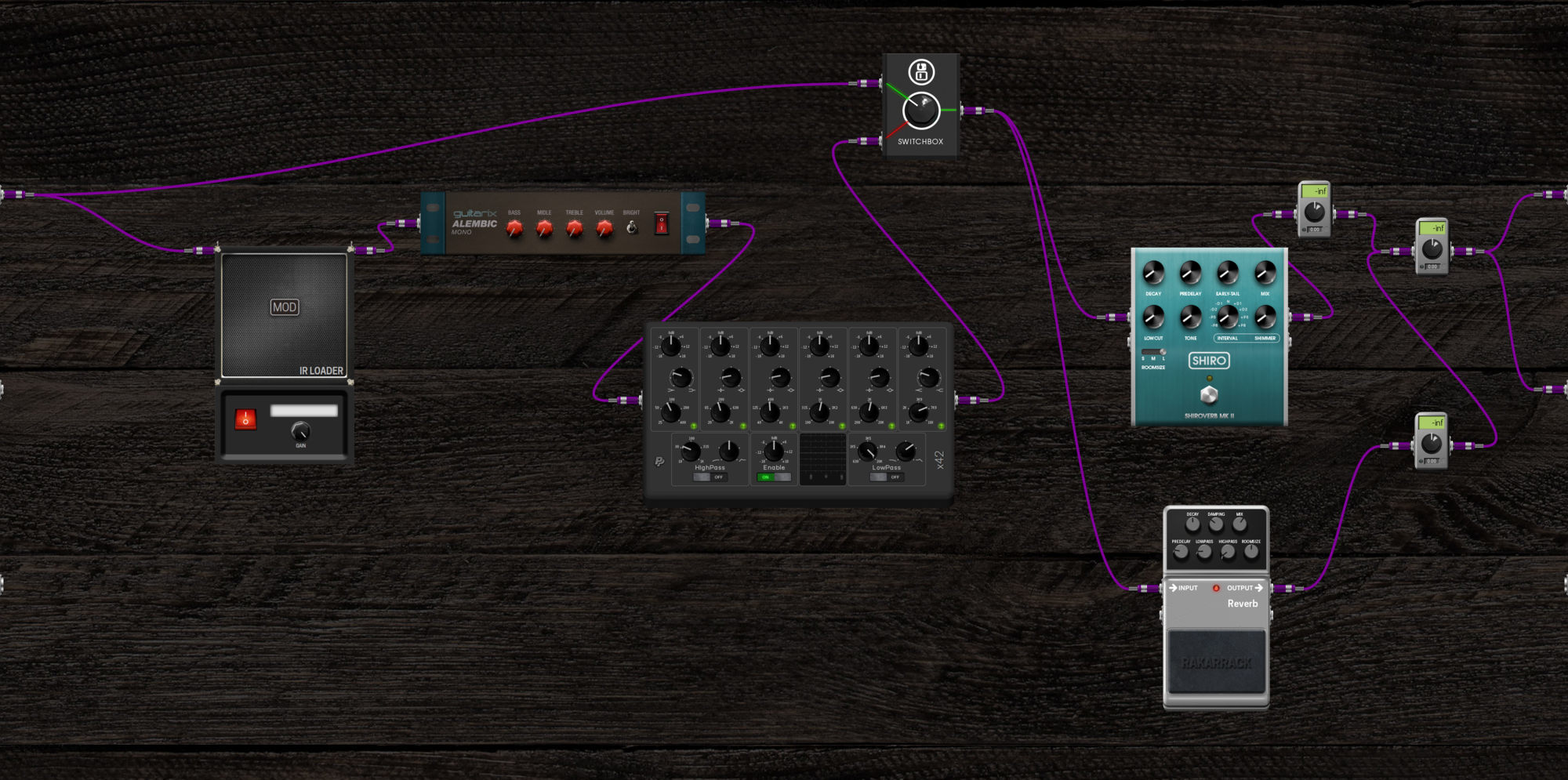

I created a little testboard to counter the piezo quack of my Fender Hellcat acoustic guitar.
The IR I used was that of a Guild D-260ce found here:
https://drive.google.com/drive/folders/1rILvexTe30Ff-jlRSEBEv8oDzEzD_ja3
the description has an error;
sample 1: WITH
sample 2: WITHOUT IR
Thanks @Matt for suggesting this method
I’ve put the Alembic mono amp + some EQ tweaks behind the IR profile in a IR cab sim
Then of course, for flavour, 2 parallel reverbs
In hte past I used the TAL II reverb but it gives way too much hiss!

Hi @LievenDV
I have to say that for my taste the 1st sample sounds better.
Could you make another sample with only the IR ( no amp or eq after ).
I think that the 2nd sample went a bit far on the low mids but maybe that is just me.

You are right
Because…
I MESSED UP
The FIRST sample is WITH the IR. (Can somebody edit that please @jon ? 🥸)

The sample with the IR sounds really Nice!
eheh was thinking the same. The first sample sounds great! Good job tamming that piezo sound. Sounds really clean and neat with the IR in it.
I’m glad I could help! Using an IR is of course not as good as using a good mic, but it allows for a much easier incorporation of effects into the signal, and it can really breathe some air into the standard piezo quack.
Besides, this is not really an either/or kinda thing. The vast majority of pro acoustic players - including titans like Tommy Emmanuel - use the pickup. Mic-ing up a guitar on stage is a pipe dream. Granted, high-end acoustic pickups with a mic blend can sound really good these days, but the vast majority can benefit from a good IR.
