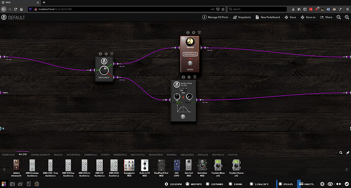

switchbox is a plugin, has regular outputs, it is not for talking to hardware, not sure where that idea comes from.
here is a simple screenshot of such setup.

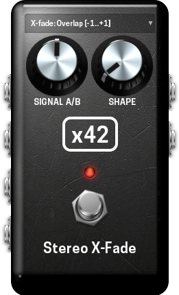

Hey, would this do what you’re after?
Thanks for the quick reply! Found this one, but need the exact opposite (stereo in, A/B out) :slight_smile:

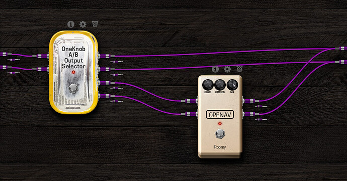

I just pushed this to the beta plugins, look for “OneKnob A/B Output Selector”
The “mode” switch does nothing for now.
And no modguis yet. these plugins are still WIP
But should work for your use case I think, like so:
