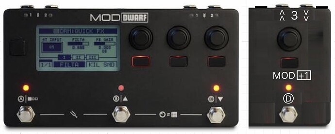

I know Mod are going to have a million other priorities right now, but Here’s a cool concept none the less that I couldn’t not mock up.
A Plus 1 pedal - connects via control chain and adds 1 input, 1 output, 1 footswitch, 1 knob, 1 page button.
What do you think if this concept? I reckon it would be super handy… the dwarf is already great, but this could just extend if users want to
That’s a great concept, and I think all of it is immediately doable except the additional input and output. :thinking:
EDIT: hardware-wise, anyway.
Having an additional input and output would allow a click metronome in the ear, or wet/dry/wet rigs - the main inspiration of the +1 pedal would be an addition I/O
Can audio interfaces be used with the dwarf?
if you mean, “can one add additional audio channels via Control Chain?”, I don’t believe that’s possible. CC is really meant for control plane type data. AFAICT, it’s RS-485
On the other hand, given your example, you could probably get timing signal from the dwarf to drive a metronome, and put a separate audio device in the expansion module. That seems like it’d take a lot of work, though. Maybe someone else here has a better idea of how to accomplish that.
Theoretically you could attach compliant usb audio devices yes. There is currently no user friendly way to set this up, though.
It is 100% not possible to do audio i/o over ControlChain, but for additional controls something like this could be interesting.
Although just 1 switch, 1 button and 1 knob is a bit too minimal perhaps ..
