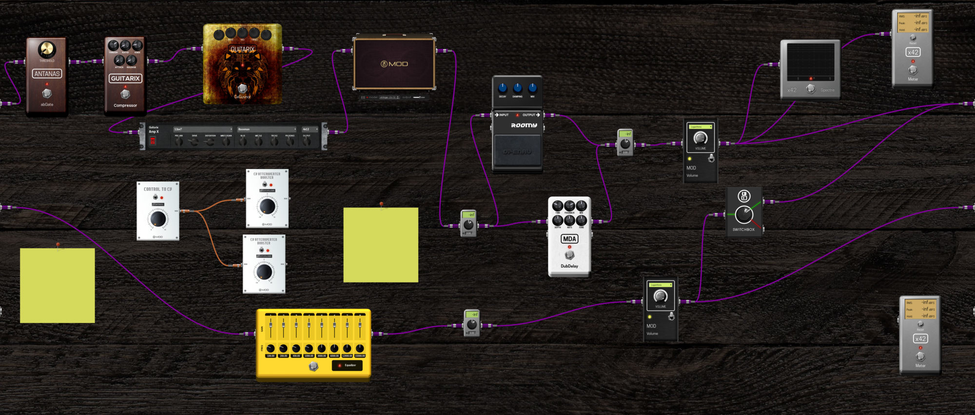

Created for my Duo. (Guit, Keyb/Accordion, mainly self-made Mp3-Backing.
We play oldies of the 50ies and 60ies but hardly any rock. But is my cash cow
Mainly I used the clean-sound. 2 Snapshot (Clean , Crunch)
2 sheets
In/Out 1 is for Guitar - In/Out 2 is for Mp3 Backings
For Rehearsal I can merge the Backings to the Guitar-Output 1
Each channel has a volume control.
Volume balance can be shifted in the range -3 to 3 dB without changing the individual volumes.
Distortion, reverb and delay can be switched on/off via footswitch.
Volume control for guitar and backing, balance control (-3 to 3) for both channels (forward, backward).
Controls for reverb mix and delay mix.
One controller is left as spare
Nice sound! Very authentic.
Thanks for the kind recognition.
This Amp X is really very good.
In the meantime I have reduced the mids a bit for myself, but this is a matter of taste and application.

Overall it sounds pretty cool and thank you so much for sharing this with all of us. I would even boost a bit this “thank you note” for all the information and description about the pedalboard and your setup that you added here. This truly helps anyone here searching for some inspiration or making a bit of “MOD R&D”.
