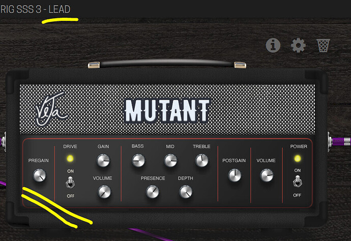

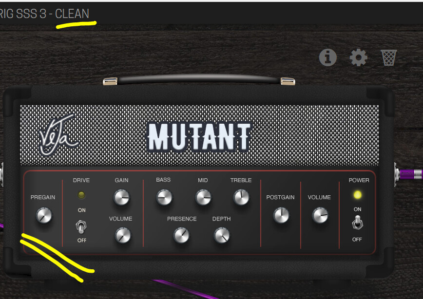

I think the problem is in the pregain knob. For a clean sound I have to turn off drive channel and put pregain at minimum.
So pregain and drive on/off are the only values I change and the spike is there.

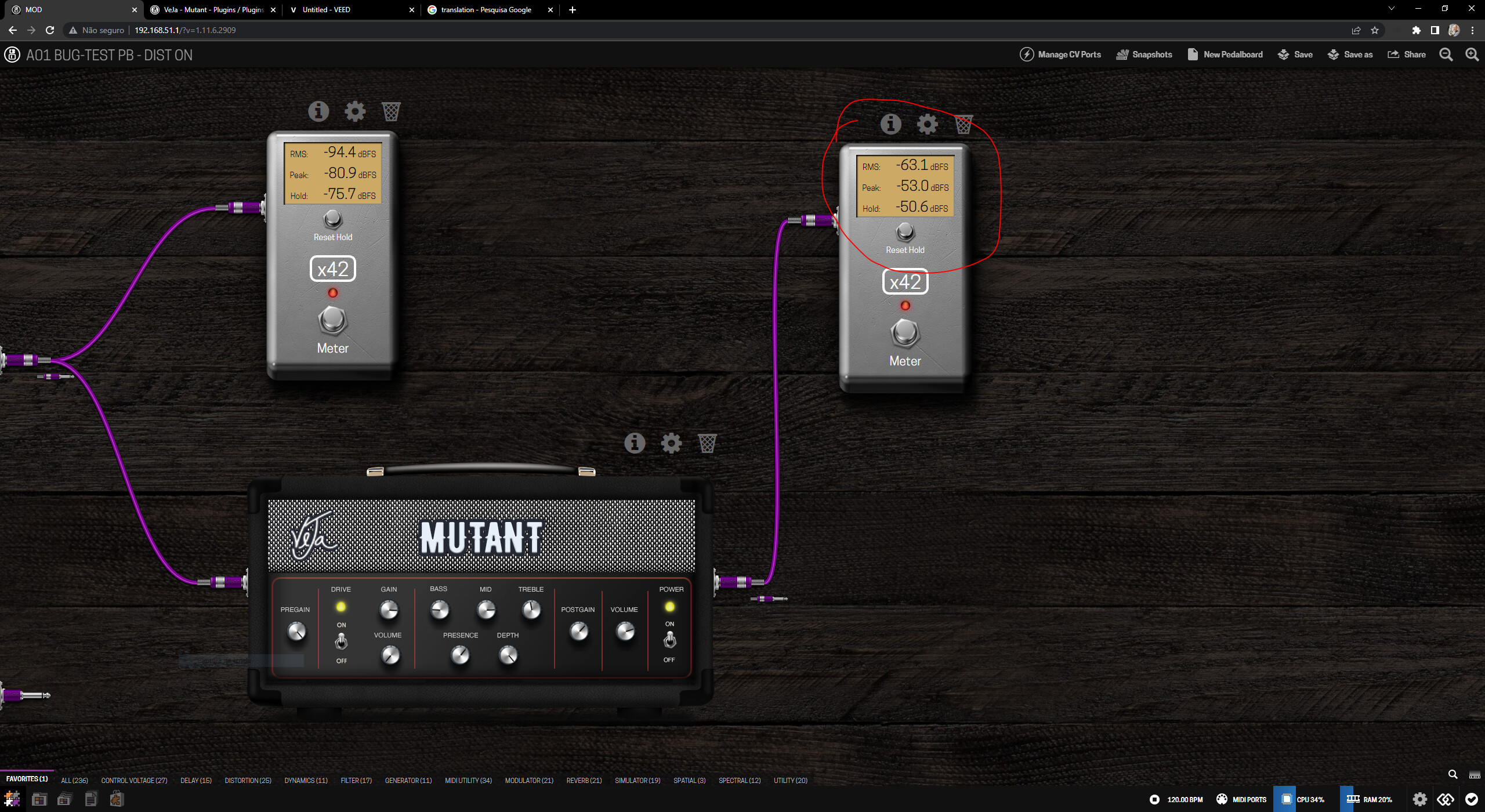

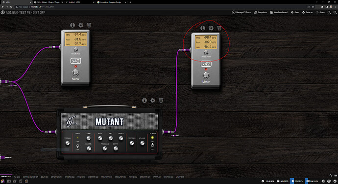

I’ve tested the mutant mimicking your settings and notice that it exists a big volume jump ( 34 dB ) between the clean sound and drive sound so I imagine that it is expected that this change can be heard when abruptly changing from one snapshot to another.
Nothing was connected on the input of the device so the level meter plugin is showing only the device noise level.
I´m not sure if my settings here are in line with your setup though.
Clean (mutant output peak hold at -84.4 dB)
Drive (mutant output peak hold at -50.6 dB)
If you are on the Dwarf I know that device has a noise gate at the input and a compressor at the output, so the fact that you are hearing a spike could be related to these settings. I Hope this help you troubleshoot the problem.

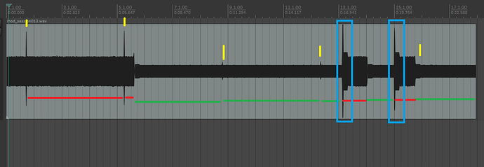

The yellow vertical line is the sample start
The red lines are the CLEAN snapshot
The green lines are the LEAD snapshot
You can see that there are some spikes on the yellow line caused by the audio player looping the sample.
The thing to notice here is the blue rectangle. When changing from LEAD to CLEAN, a 2-steps spike happens: a first huge spike followed by a lower step then followed by normal CLEAN level.

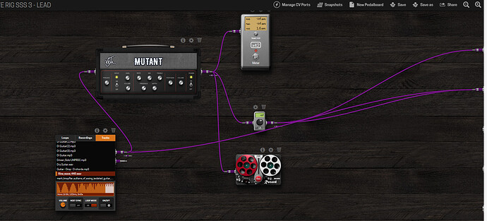

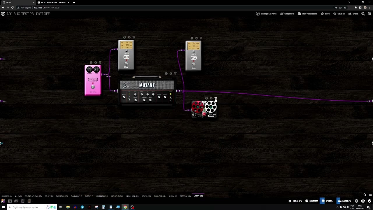

This is the setup I’ve used.
No matter what’s the volume difference between two snapshots, I expect a clean/straight behavior.
If CLEAN snapshot is at -10db and LEAD is at -20db, I expect that switching from one to the other in A/B loop test should act like this
A(-10)…B(-20)…A(-10)…B(-20)…A(-10)…B(-20)…A(-10)…B(-20)…
but what I see is something like this
A(-10)…B(+10…0…-20)…A(-10)…B(+10…0…-20)…A(-10)…B(+10…0…-20)…
