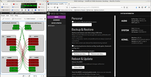

The chroot image runs now on the host and latency seems ok.
Looks like a docker image could get real.

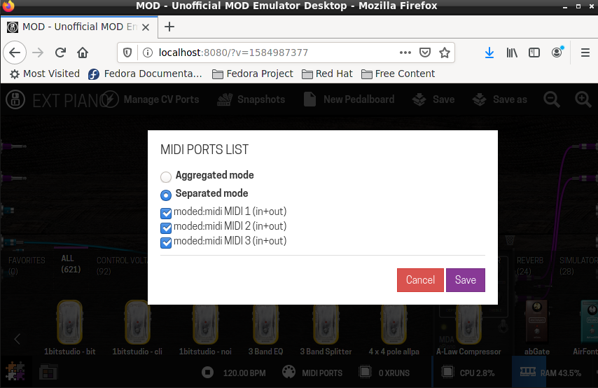

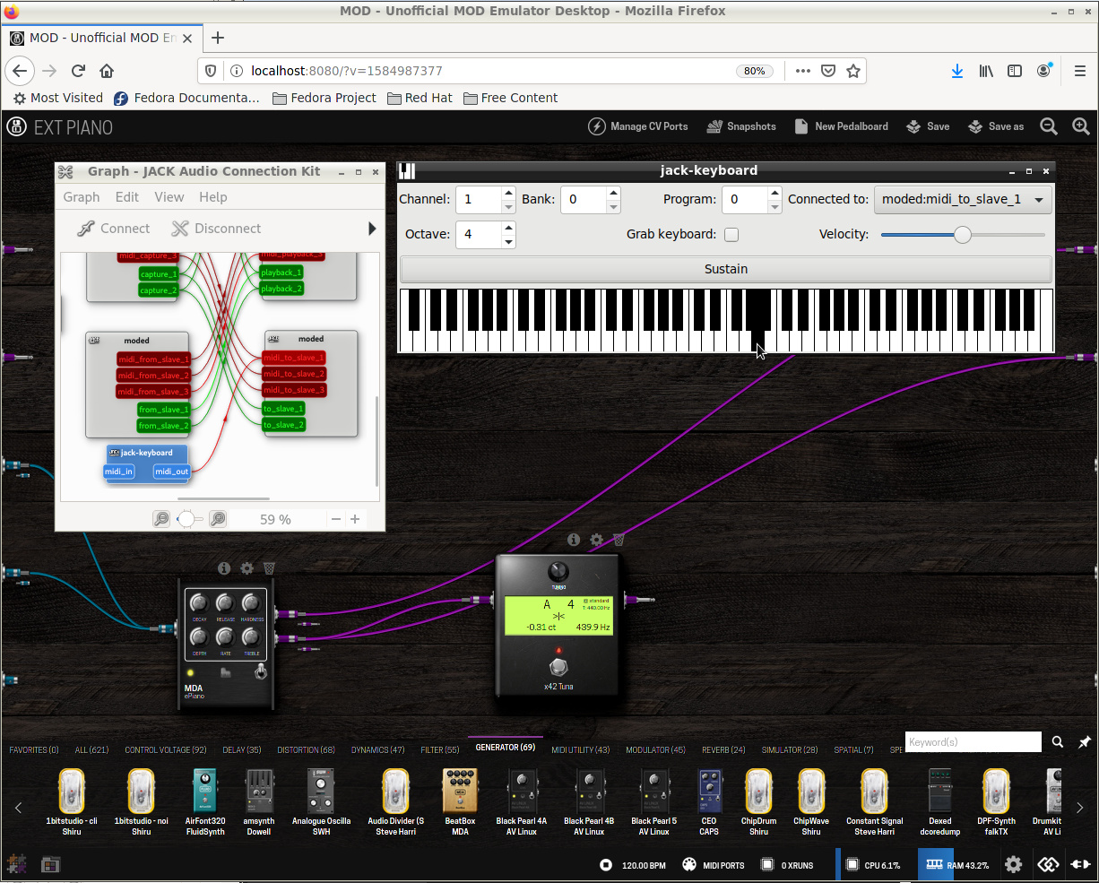

In my case a x64 image that can be used on a Linux PC.
Something like this (here running in a chroot):
That would be great! :wink:
