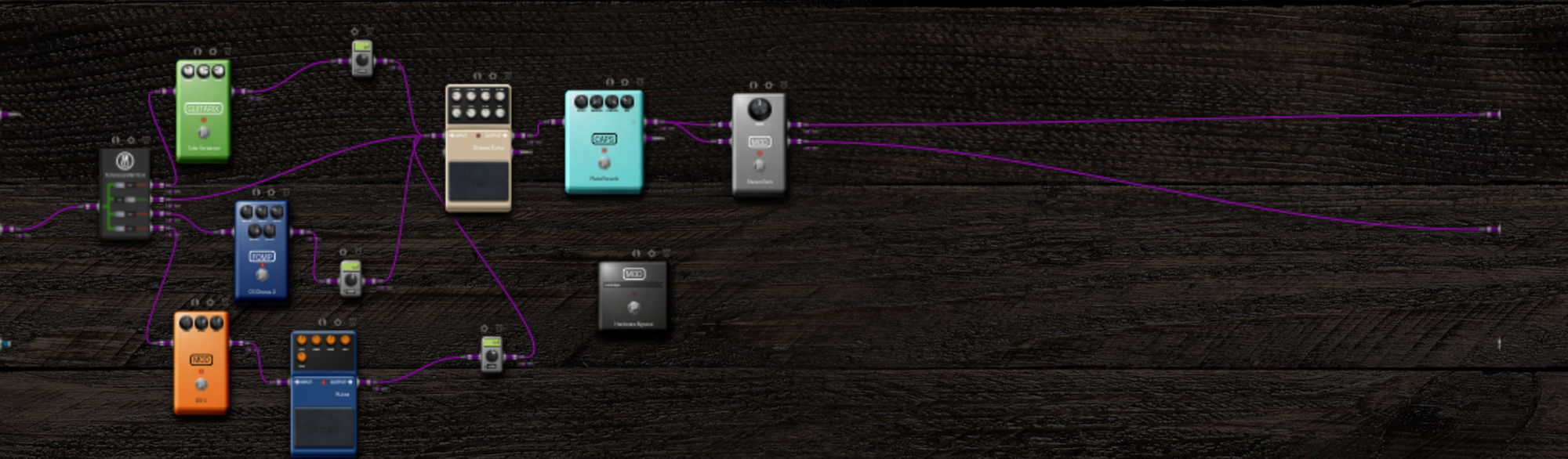

Thinking of sharing for the “GBP” I created a basic all purpose pedalboard so a user that is new to MOD could plug and start playing right out of the box but I got stuck when recording the sound sample.
Here it´s the pedalboard.

Actually on 2nd thought though, @rogeriocouto, are you setting your output gain to the lowest possible setting? If your signal is that quiet that the digital recording is very hard to hear, you aren’t using very much of the resolution of the DAC. Its probably plenty good, but if you can crank up the digital signal at the end of the chain and just attenuate it with the amp after the DAC it will be a “theoretically” better signal. With that setup you might have better success recording samples too. I haven’t played with the input/output gains much really so I’m not sure how much headroom there is there.
I took that into consideration and checked my volume and gain settings again. My output is set 0 Db in both outputs but my inputs were set to -6 Db which I altered to -5 Db and that give me occasionally yellow leds on the input.
The stereo gain plugin at the and of the pedalboard chain is set to 0 Db in all presets including one preset with no effects which I use to compare the volume with the hardware bypassed signal.
Hopefully the hardware bypassed signal will be equal to the processed “no effect” preset when I hit the front of my amp.
Ah but that just confirms exactly what I was thinking. Try this: 1. unplug your amp,and any headphones, etc. 2. Turn the stereo gain plugin at the end of the chain up until the output LEDs show red when you hit it hard, then back it off a tiny bit so it never clips (goes red). 3. Go to the gain settings in the menu and turn down the output gains. 4. plug in your amp and slowly turn up the output gains until it seems that your amp is getting the level you want.
0db out is pretty hot. Your amp can (heh) amplify a much quieter signal. Perhaps its counter intuitive, but you will actually have BETTER sound quality by turning it up digitally as loud as possible and turning DOWN the output gain to a reasonable level. Because your output gain has been so high, your patches have been designed to output teeny little quiet signals that get boosted by the output amp inside the MOD.
Does that make any sense? Give it a whirl and let me know if it doesn’t work.
Thanks a lot @ssj71
I misinterpreted the audio signal flow and for some reason I thought that output volume control was before the DAC and for that reason I had it all the way up.
Now I have the gain plugin at +3 Db and the output rolled back to - 3.5 Db. That will give me better signal to noise ratio and the shared pedalboard sound samples will be a little louder.
