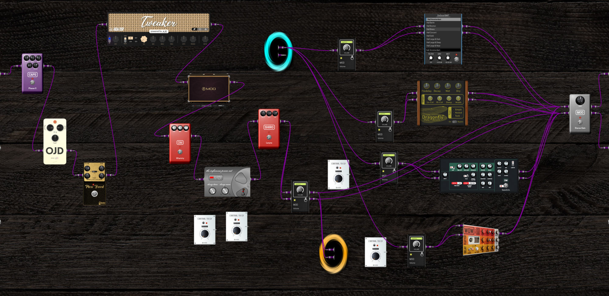

Regarding the Edit feature on the Dwarf, I’m testing version 5 beta and I still have some freezes when I try to enter the parameters of some plugins, this happens for example with the BM7 (reverb) in this pedalboard (256 frames). Same issue with other plugins in more loaded pedalboards.

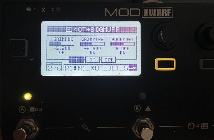

Another minor bug, not very important but…, about On Device edit:
  1. If you click the MENU button (configured to latch) you enter the Settings Menu. If you click again the MENU button you exit and go back to the main page. Good
  2. Inside the Setting Menu, if you click the EDIT button you Enter the On Device Edit. If you click EXIT you exit and go back to the main page. Good
  3. Inside the Setting Menu, if you click the EDIT button you Enter the On Device Edit. If you click the MENU button you go back to the Setting menu. Then you click again the MENU button to exit, but nothing happens. Not so Good. (the way out is going again to On Device Edit and click EXIT)

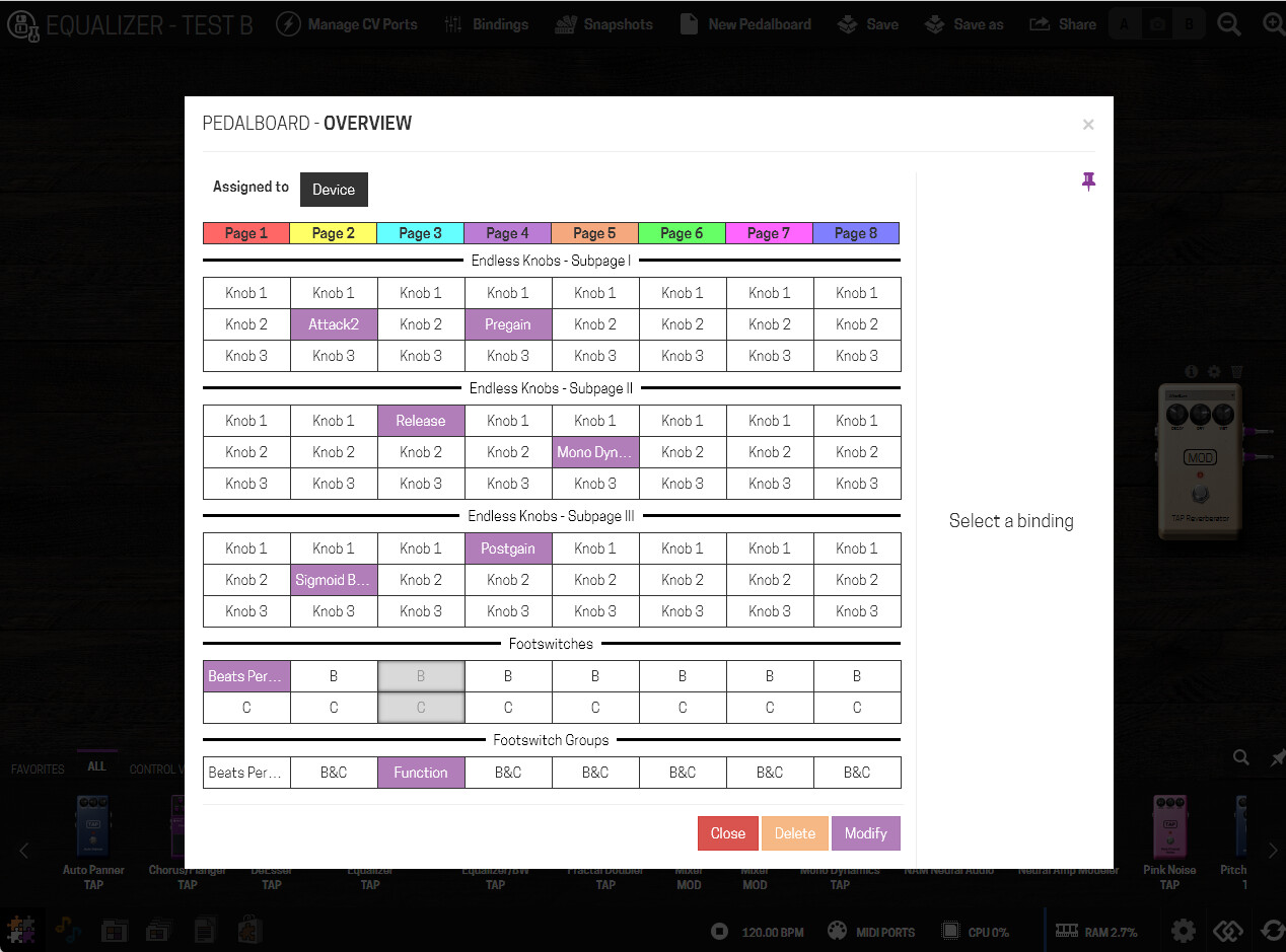

Global pedalboard binding management
As I’ve anticipated the next Starless version, which will be released this weekend, will include a new global binding overview.
This is only the first iteration, the design is basically taken from the @rom proposal which in my opinion it’s very functional and nice.
Due to some time constraint, I decided to only release the device part, midi & cv will be added in next releases.
How it works

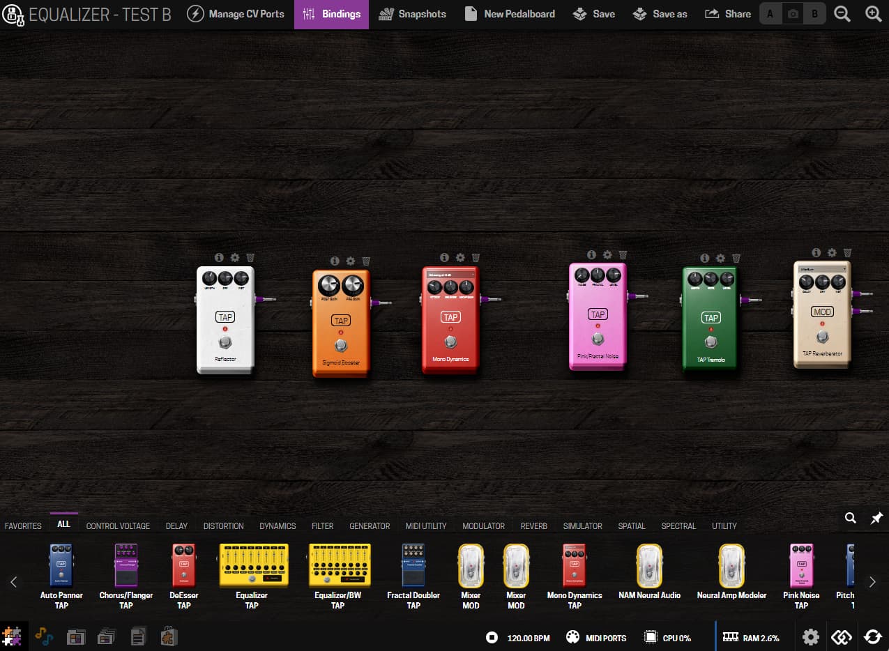

The new function can be reached with the Bindings button on the constructor toolbar:

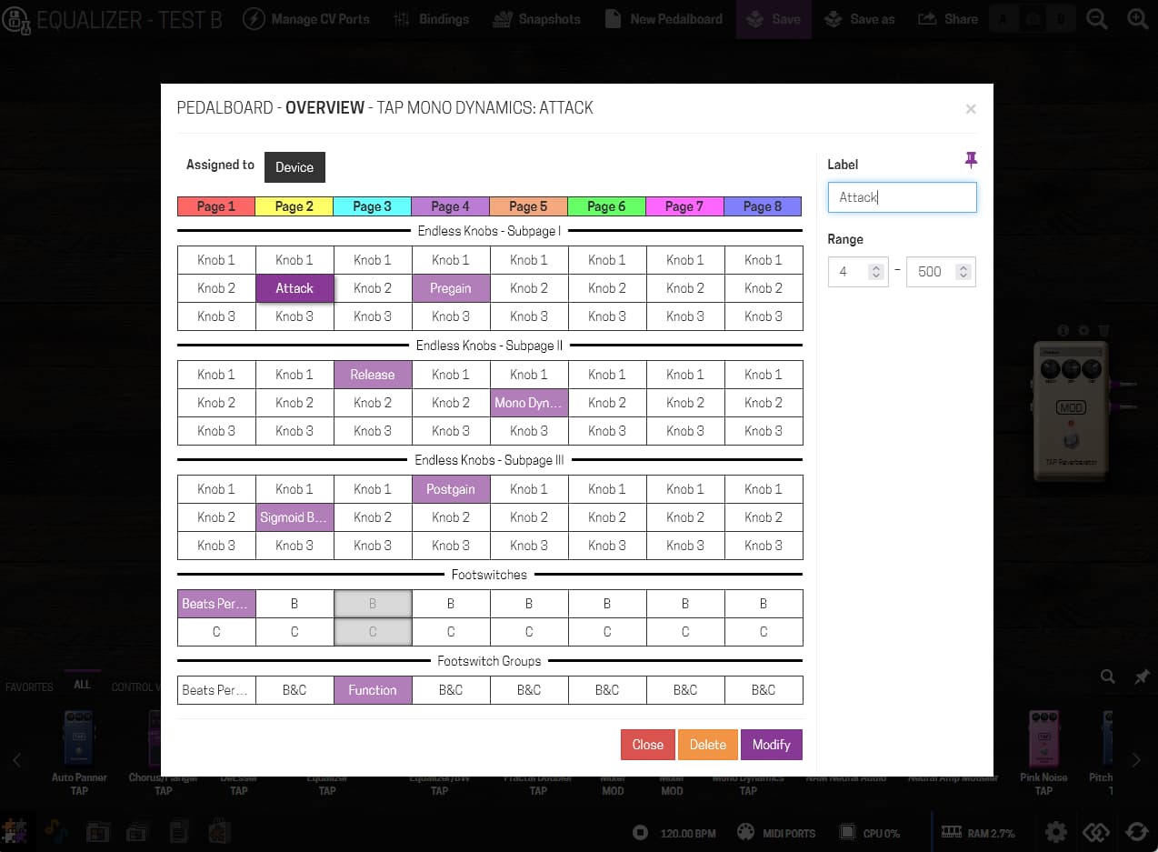

After clicking the button, this new dialog will appear, showing the assigned controls:
The advanced pane is now pinnable using the toggle on the upper right corner, this pin setting will be remembered and it’s the same for this dialog and the usual per “control port” dialog.
When you select a binding, by clicking on its cell you have access to the following function:

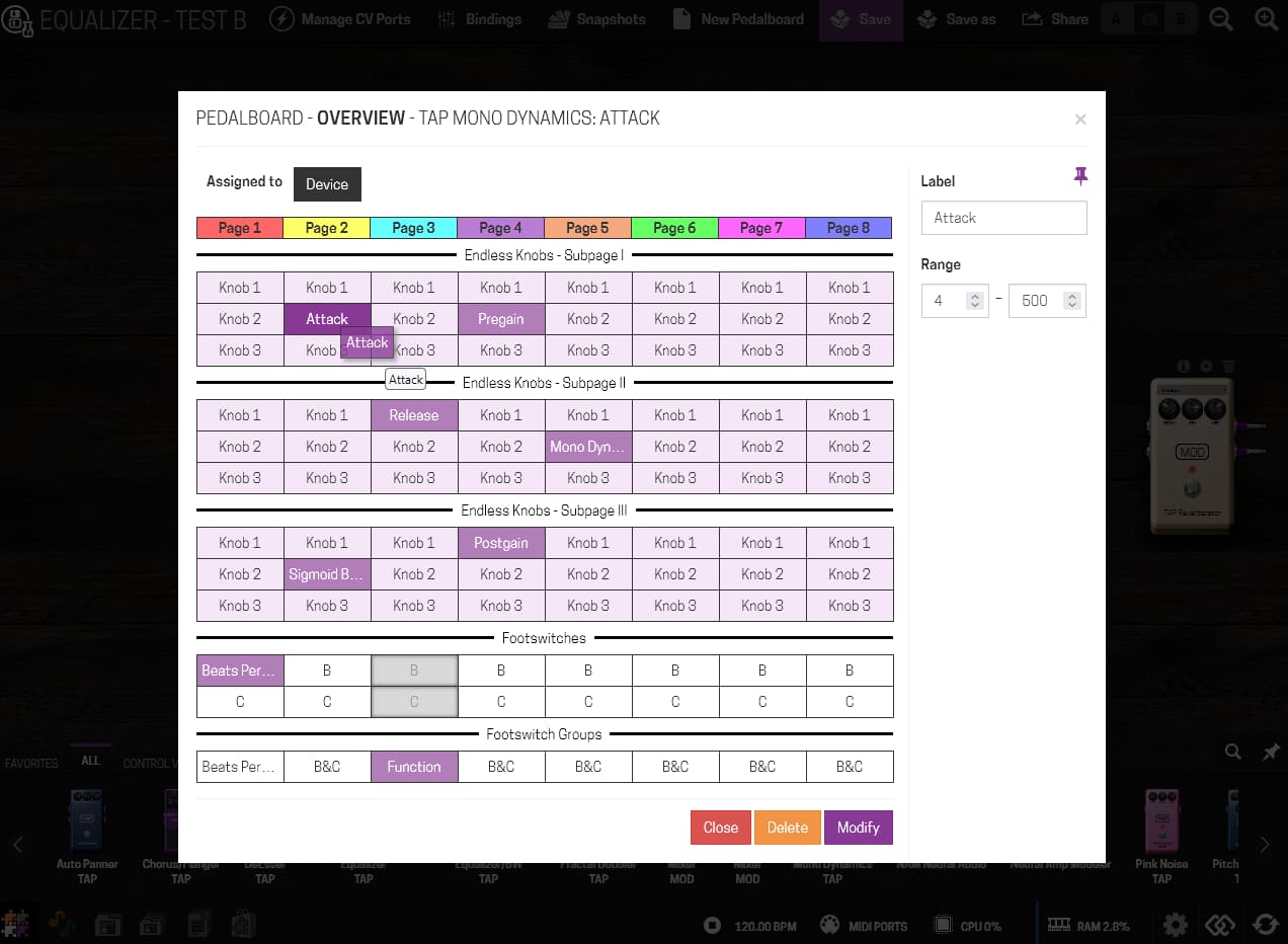

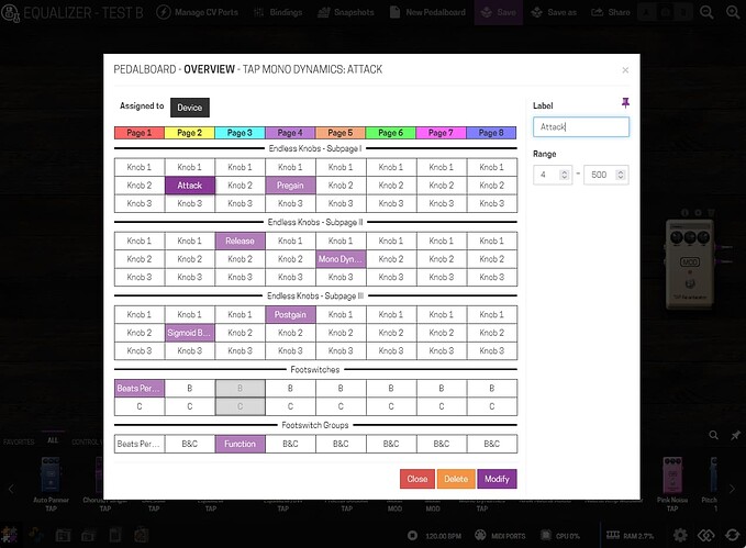

  1. You can rename the binding or change the range like you will do in the usual dialog (when done click on the Modify button)
  2. You can delete the binding with the Delete button

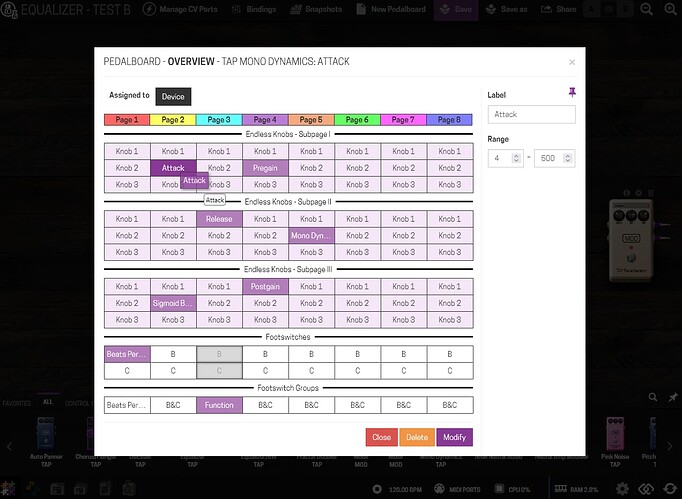

  3. You can also rearrange the binding using drag & drop:

Right there’s a minor glitch, but I don’t have a optimal solution.
  1. We can disable the MENU (shift) button when in edit
  2. We can remove the edit button when the MENU is called from the builder itself
  3. We can change the edit button to exit when the MENU is called from the builder (but there is so little space and exit is not so clear: exit from what?)
Any idea, I’m leaning toward 2…

Or you do like the save button, which is option 1. Menu button does nothing in the save page. You have to click exit.
Or you do like the settings menu, where clicking menu moves between the menu page and the settings page, till you exit from settings. (A little strange anyway)
I think here the point is that you have a very overloaded pedalboard which needs 256, otherwise a lot of xruns. But the last pedalboard you used was lighter so you changed in the browser to 128. Now you are hopefully at rehearsal and want to show your friends this crazy pedalboard, but no browser.
