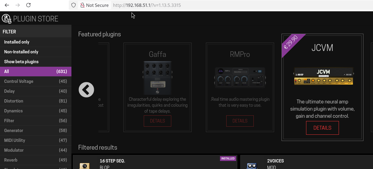

Hi @jon,
can you be more specific about the mod labs in the plugin store?
Because I just reflashed to original firmware and I see mod labs there with it too:
From my understanding the switch is present if you check “show mod labs plugin in the store” in the advanced settings page:
Thank you!

Andrea, you’re right, the latest official release we can download has that layout.
But I’m sure that the one that was fetched OTG was different: the ability to visualize beta plugin was a filter similar to “Ïnstalled only” and was something like “Include beta plugins”.
Bye
Yep you are right, I remember the beta filter like you described.
Hey @AndreaDelSignore, from where did you install the image? From the one available in the wiki?
On the official image, which is called “show beta plugins”.
If you installed the image from the wiki and that stayed like that, it may be something else and I would suggest that you do a factory reset (with all the security backups) and see if that goes back to beta.
Anyway, I guess that with that image, the plugins that appear with the Labs switched on, are exactly the beta plugins…if I’m not wrong.
I think that I used the stock Open Image, when home I’ll try also with the last official signed release from the wiki.
Thanks
Download it from here and tell me if it still happens.
Can confirm, in the official signed release the beta plugins management is a little bit different:
I don’t think is important, but now we now that there are “some differences” between the code included in the released firmware and the open image.
