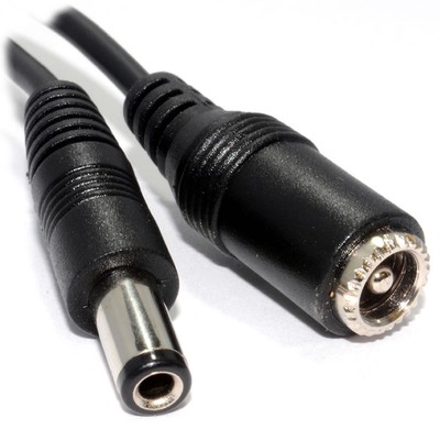

If you’ve gone down the new power supply route and found that the cable on the new one is a bit short, you may want to get one (or more!) of these. I got a couple of 1.5m and a couple of 3m - arrived today!
(not planning on joining multiples together - just nice to have spares!)
