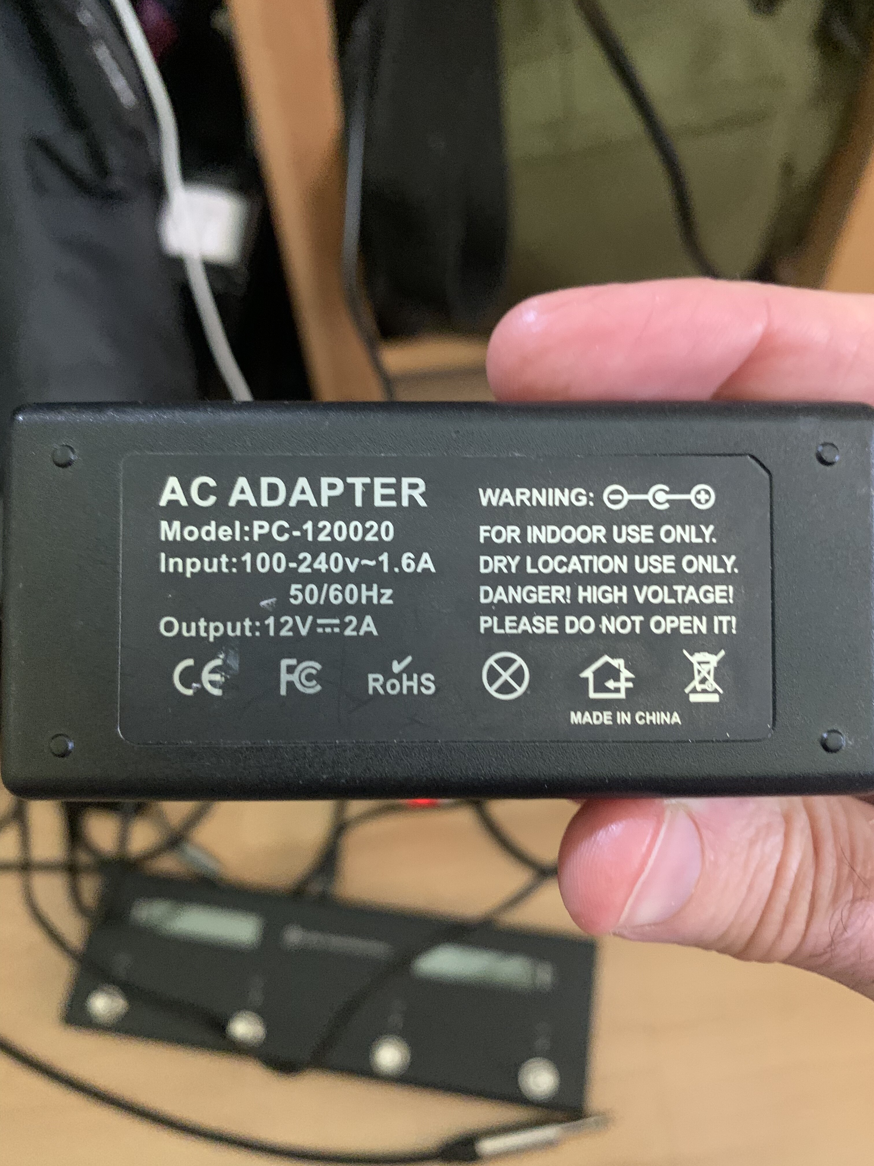

I actually don’t have an issue with the lack of ground on this supply.
The adaptor has that box inside of a box. Which I guess means it’s safe to use in This application

I believe Elk_wrath is saying it is double insulated, which you can read about in what looks like the first page on the internet at GCSE PHYSICS - Mains Electricity - What is Double Insulation? - What is the Symbol for Double Insulation? - Which Appliances are Double Insulated? - GCSE SCIENCE. You can see the double insulation symbol in the image on Amazon that was linked.
That is exactly what I meant, glad there are smart people here lol

You should be fine with running that power supply. The double insulation is there to prevent any sort of electrical shorts without needing an earth line.

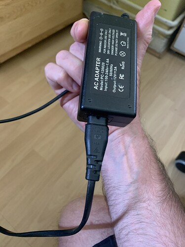

Also, another user has confirmed the power supply issue here: How I solved my noise issue - #49 by MikeFlynnBass

As I explained on the other thread when I switched to the duo power supply the noise disappeared and when I use the dwarf power supply on my duo, the noise is also hugely reduced if not fully gone, but certainly usable on a gig I’ve yet to try in recording situation
I hope that helps add to the pool of information on this issue

I had already mapped your comment and passed it to help us on the investigation. I really thing that your finding may turn out gold (after all it seems that we maybe had one solution before). Out of curiosity, could you share a picture of your Duo power supply? So we know exactly witch one are we talking about?
Pics above
