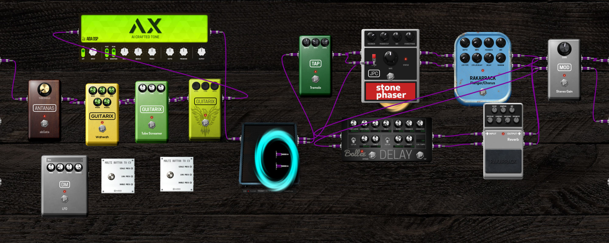

So this firmware is faster on modduo but i found [some bugs, webui refresh is heratic, can’t see what is active or not, it doesn’t refresh, tried to empty caches, change browser (opera, chrome , firefox), nothing refresh leds on effects on screen. I put an LFO on the wah buton and i don’t see it moving but the sound work. I tried with only LFO+Wah and i see it moving, may be when too mutch fx on screen Webui bug…]
Solved it’s a cache problem, i use private page and it work.
[ Midi with my chocolate (4 switch) bar sometime does not work , i suspect “Muti Buton CV” plugins, i use it to have 3 butons on one, normal, double click and long click. i have 2 other buton without it and midi is ok to start fx pedals. ] Same problem of webui cache, too mutch animations on screen killing all, can you remove teleport anim ?..
