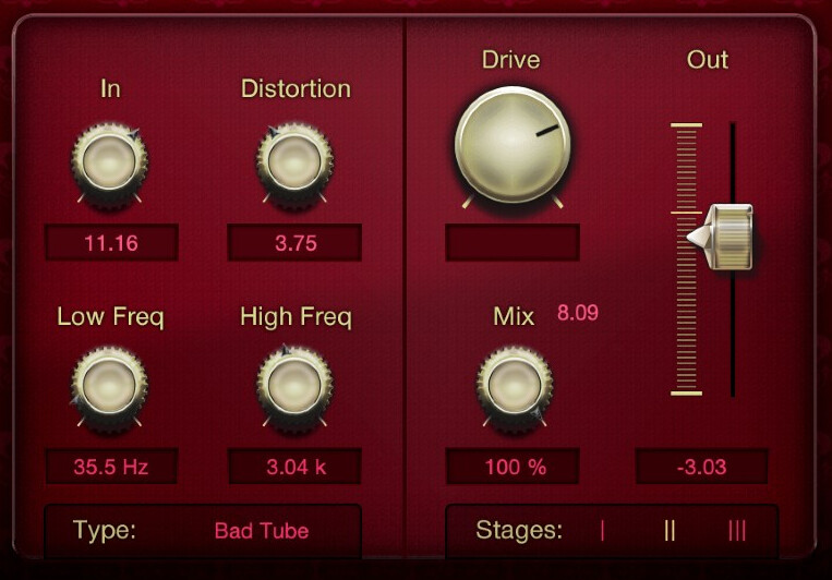

You’re right in some cases but it’s a slippery slope I think. It’s very easy for it to fall into the uncanny valley if you’re not careful. That’s why I did more of a “caution” sign rather than a tick or a cross because it can go either way. If it’s done in a subtle consistent way without too much detail I think it works. Here are some examples of where I think it works
In contrast, if you go to far it can start to look a bit uncanny
Here I think the perception of value is diminished. I think value perception definitely exists on the completely flat end though
No, I think this is pretty safe. I personally would remove the thin border around the indicator line. I don’t think that amount of detail is needed. This is a pretty clean design though. I will just point out that it looks quite strange on my phone

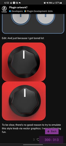

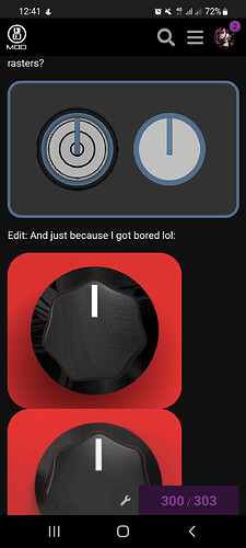

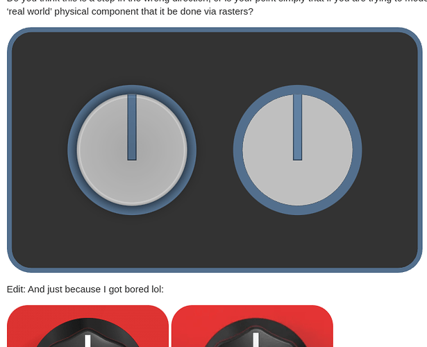

Woah! the one on the left is a vector graphic? if so I’m very impressed. How did you do the highlights and shading with such specific shapes? I can see a value in making elements like this
Do you mean on the very edge where it’s pixelated? it might just be the way I cut it out on photoshop. Or do you mean the geometry or lighting on the curve of the corner?
I can understand that subjectively you have a preference but in terms of realism we can objectively say that it is less realistic as the textures and lighting are not PBR and the corner geometry does not match the real world device
That’s concerning. I don’t see that on my phone. Granted, that export was done quickly without any optimization or QC, but it’s a stark reminder that SVG is subject to different browsers interpretation for rendering.
What phone/browser combo are you using?
It’s kind of ridiculous honestly - 12+ layers of gradients with varying opacity and blend modes. This particular example was rushed, and would not look right when animated - but if I took more time that could be corrected.

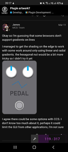

It’s not as bad on the second knob you made
I’m using a Galaxy S21 and Chrome
That’s impressive! Hmm something I found with SVGs is that browsers don’t support all types of gradients and blend modes that are available in the software. Linear gradients and circular gradients work fine but path driven gradients don’t seem to work
Those really look terrible.
I’ve tested on my PC with Firefox and chromium, and on my Motorola with chrome and brave, and they all look like they should.
No path gradients have been used.
It’s quite concerning that rendering can be that different.
Is anyone else seeing these types of rendering errors?

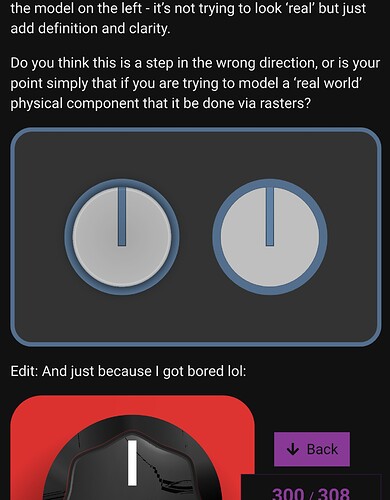

The knob at the bottom seems to be rendering in a strange way
In which way ?
Here is on Kubuntu witch chromium, I don’t see any difference with firefox on android :
On this screenshot, you can see tearing on the image at the bottom
that “tearing” on the bottom knob is what i see with firefox on android as well.
