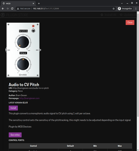

Guys! We did some experiments on a mono Audio to CV Pitch plugin that may help you with a mono “pickup” conversion in this case to CV.
You can find it on the beta section and it’s called…super creatively…Audio to CV Pitch ![]()
Please note that this is still a beta plugin so it may be more or less buggy - I tested it myself and it seemed “okayish”. It’s also not categorized, so after install it please search for it on all plugins.
Bug reports are welcome. Feedback overall as well.
Enjoy ![]()

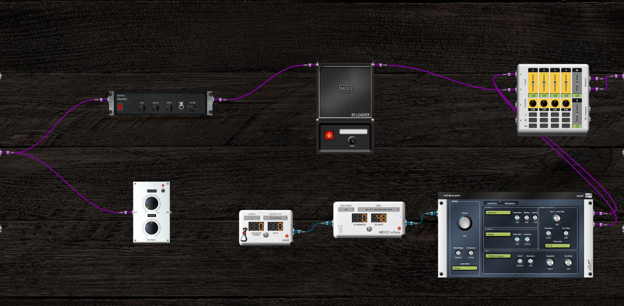

I recreated what I tried here (I didn’t save my initial test)
The basic idea is that I’m trying to blend the synth with mono guitar lines and Initialy I tried this. There isn’t anything more than the basic set up (no reverb, distortion or something like that)
I’m kinda bad with CV so some feedback and tips would be really appreciated
Are you able to convert it for the synth at all?? Because if you do, I guess it’s some sort of bug of the system.
You are just converting the audio pitch to CV and making nothing with it. You will need at least a VCO (oscillator) more and a VCA (amplifier) and an CV Envelope may also help you. Then you need to output it as audio.
Please note that this plugin is a Pitch to CV and not a Pitch to MIDI, so it will not help you a lot with synths and other generator plugins that use MIDI only to trigger the notes.

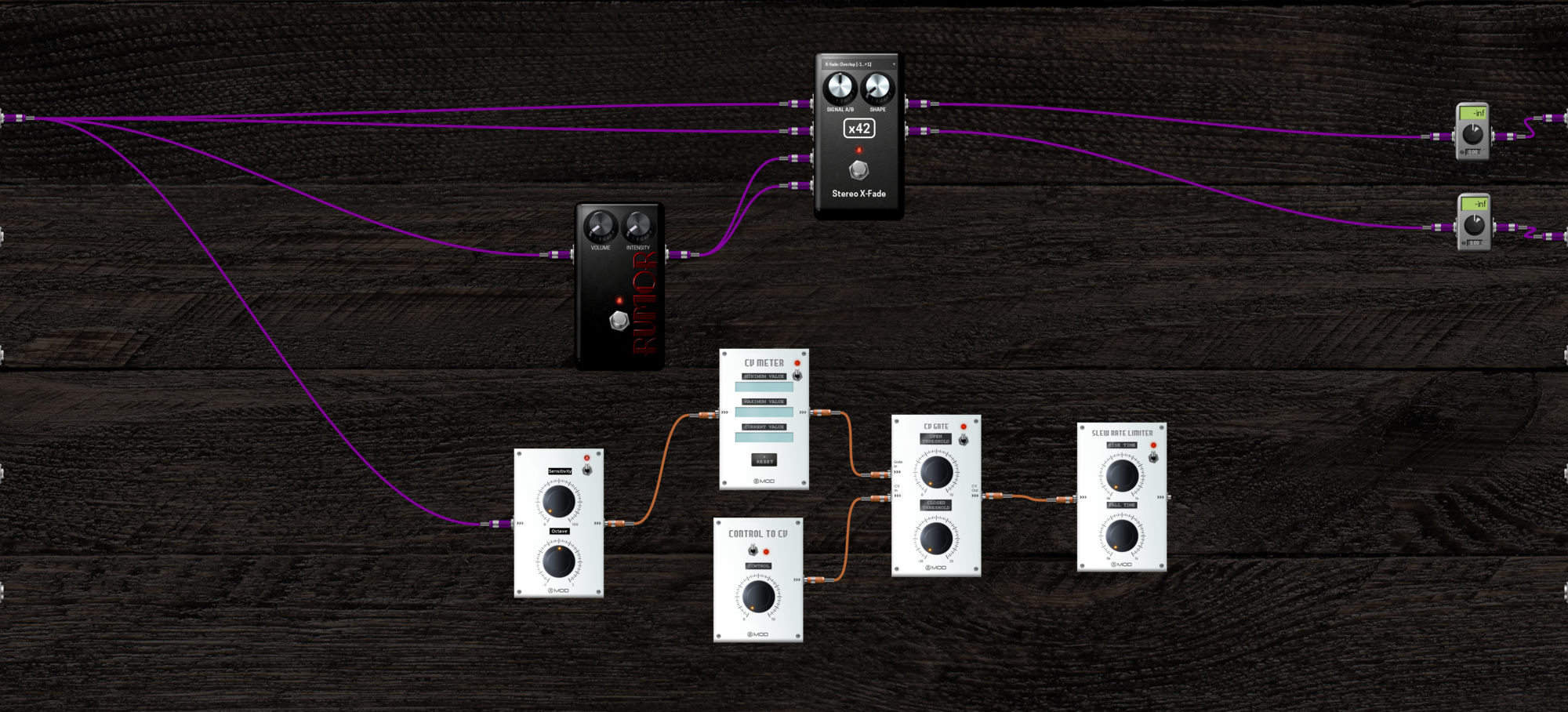

I really like this plugin, I was looking for a long time to use different effects on different registers of my bass guitar! There are still some things that don’t seem to work though:
1.) The plugin only works correctly with 256 frames on my ModDuo, otherwise everything is transposed one octave higher.
2.) With 256 frames the effect works down to the low G on my bass-guitar. Is there any chance to make this work down to low E?
Update:
I used the Capo Plugin to transpose the control path 3 halfsteps higher, still not perfect but usable now down to E.
Just as a quick example I uploaded a pedalboard which switches between 2 effect ways based on the notes you play:
