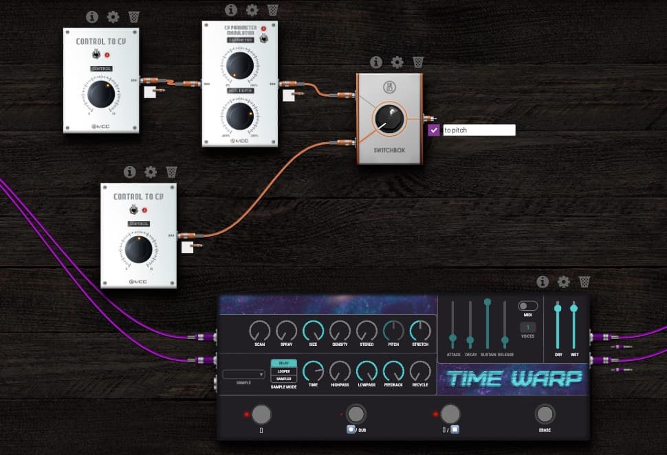

I always have the same problem with the pitch parameter of some plugins, the only workaround I found for live situations is two CV controls, one fixed to Pitch=1, the other one variable and a switchbox…
thanks for working through so many possible solutions. I’ve no idea if MIDI mapping just allows for the 0 point to be a few percent ‘longer’ than the rest of it…
No, it doesn’t. But making 0 the upper or lower limit should make it easy to reach that value.
