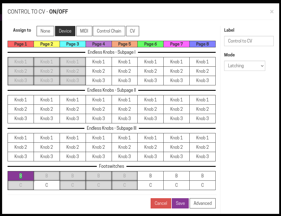

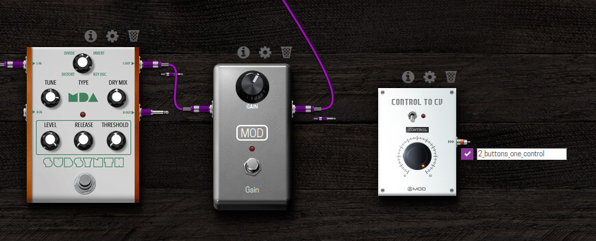

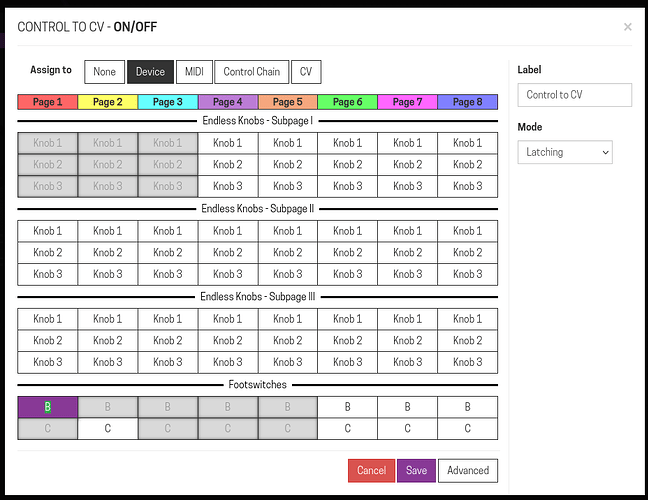

i had no idea to use the Control to CV - MOD Audio - that works as well. Btw: i’m controlling 2 Buttons with this one Control to CV
And after looking closely i’ve found the “Advanced”-Button :slight_smile: to label the “Control to CV” … thank u as well for mentioning, there is a flexible way to label Footswitches.

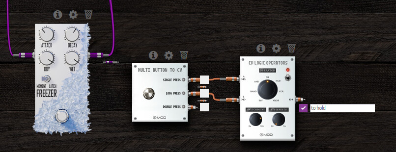

I - of course - tried then to label the Multi Button … but as you said: can’t show a proper name by design. Makes sense from this point of view. But it’s a pity, the labeling doesn’t show the name before the footswitch is pressed.

PS: I use the Multi Button to CV for the Freezer to have a momentary or fixed freezing. Got this idea from @zwabo in this Boreas - Yet another freeze plugin - #11 by zwabo thanks for that hint as well
