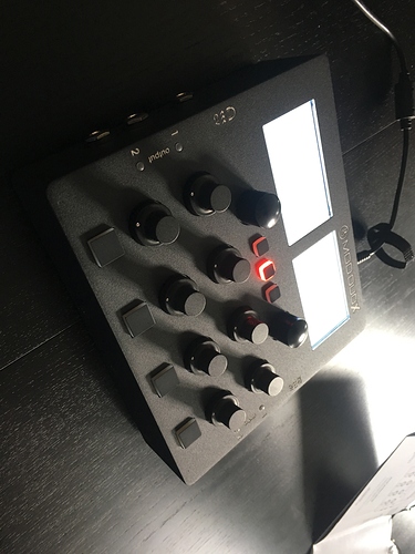

It just appeared on my desk. I was ready to wait a few weeks more, but here it is - serial number 4, and I am happy as a boy can be.
Let’s see what this beauty can do for me. First impression: this is going to be a lot of fun…

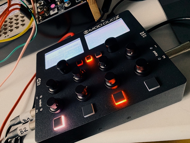

The Duo X comes with a selection of CV modules to fulfil all of your modular dreams.
is there more info or larger pic?
We will be releasing the CV related plugins in 5 days.
