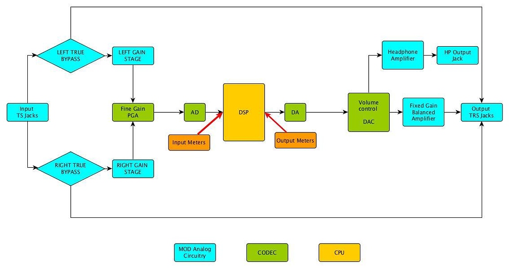

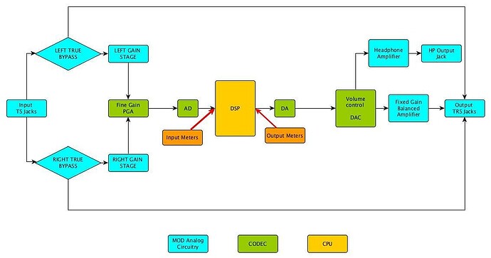

@brusch and @Bollie
Hello guys.
The topic below helped me a lot to better understand the audio flow inside the MOD DUO.
Thanks, @rogeriocouto
Unfortunately that doesn’t answer my questions regarding the input’s “Stage” settings.
Thank you - this explains some of my misunderstandings.
In this case yellow is no problem at all… I thought that yellow is much hotter.
Nevertheless a peak meter would be nice…
