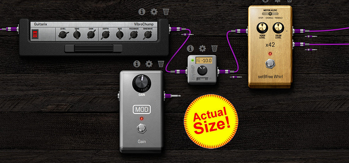

I had a quick go at it. I suppose it could be even smaller – but then the 1/2" jacks won’t fit inside :wink:

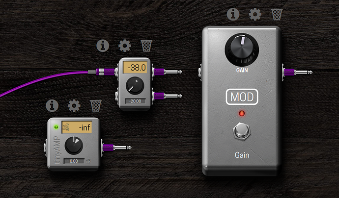

I’ve tried a bit harder. the minute amp :stuck_out_tongue:
Alas, it’s not great. The problem is that the jacks constrain the height - particularly for there stereo version; and the info/edit/delete buttons above a plugin define the minimum width. So one might as well use that space for a output-level display and a “bypass LED / control” and keep proper labels, too.
The source-code can be found at GitHub - x42/tinyamp.lv2 · GitHub and a pre-compiled binary can be pushed to the MOD on unix-like systems like:
curl http://robin.linuxaudio.org/tmp/tinygain.lv2.mod.tgz \ | base64 \ | curl -F 'package=@-' http://192.168.51.1/sdk/install
As usual feedback is welcome.
Very nice! I wonder if one could even integrate it into a cable (or have a very quick way to add it to a cable besides dragging it and connecting the jacks - more like a click-on-cable-select-add-gain action)… But the minute amp is pretty awesome, too: So Gain, Much Small, WOW :slight_smile:
I can make the ‘(i)’ icon hidden if a certain property is present on the ttl, sounds useful for cases like this.
The height of the jacks will not change though, for consistency.
Now that’s a pretty cool idea. When a new plugin instance is dropped on a cable: insert it. Probably only works for 1in/1out (mono) FX, everything else will be hard to get right. Likewise remove (maybe shift+trash click) could keep the chain for N-in/N-out plugins.
heh. After some sleep and falkTX’s suggestion (no info-icon property), I’ve opted for the minuscule amp. The scaled box’ corners and shadow look a bit odd due to scaling, but that’s a nit to be picked later.

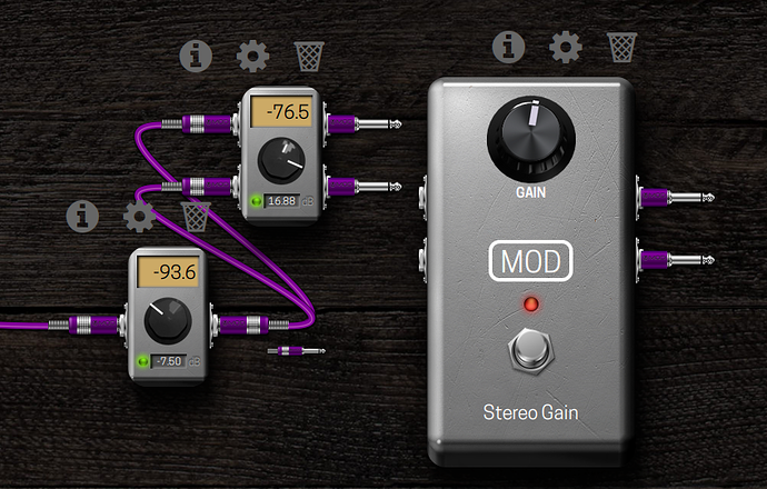

As per suggestion from @Bollie I’ve re-purposed the Enable LED/Control to be a “Mute” (bypass/enable is still click-free, but only available in the “Edit Window”).
New version is available from the same URL (http://robin.linuxaudio.org/tmp/tinygain.lv2.mod.tgz and src on github). I guess it won’t be long until this shows up in the MOD store, but it’s unlikely that it happens before the LAC.
PS. The background color of the DPM display now changes depending on the signal-level:
<-18dBFS: pale green <-3dBFS: green <-1dBFS: ocher < 0dBFS: orange >= 0dBFS: red.

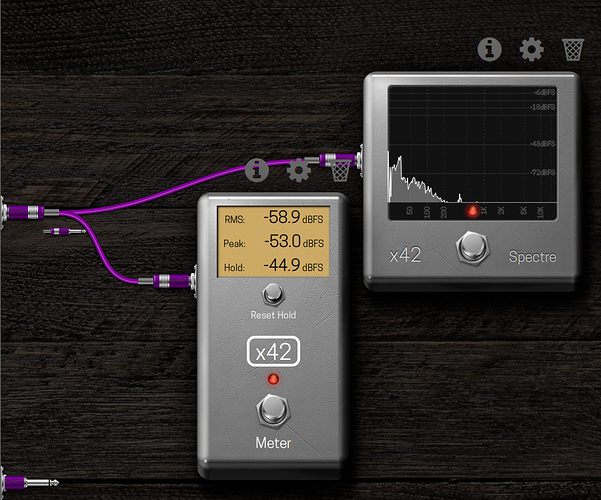

I’d love to, but I can’t. I’ve just dusted off the MOD and measured it. After terminating the analog input, tne selecing “gain-stage: mid” (under “Volumes and Gains”), the noise-level is in the -50dBFS range. The main issue is still a DC offset or low-freq noise.
You can also record some audio (ssh into the mod, use jack_capture --channels 2 --port system:capture*) and analyze that off-line.
In theory the analog circuit should be a lot less noisy.
