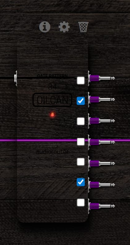

I am almost there. I have the audiorouter nearly done. I’ve got the html ui set up - but just one major final thing. I dont know how to make the graphics appear. The background is supposed to be blue.png, the knob is supposed to to be aluminum.png. Using the various “boxy” things in the docker file it worked ok, but when attempted to run after the build, I get a transparent body (which should be blue.png) and no button at all (which should be aluminum.jpg). It seems the subfolders in the utility docker arrangement dont exist in the mod, but I did try moving the relevant graphics into the modgui folder, and editing the stylesheet accordingly but that didnt appear to work.
Any idea what might be wrong?
Thanks in advance
Hey Steve,
You have defined this in your modgui.ttl:
modgui:model "boxy" ;
modgui:color "blue" ;
modgui:knob "aluminium" ;
This results in certain css classes being set. The first html line will transform
<div class="mod-pedal mod-pedal-boxy{{{cns}}} mod-{{color}} {{color}}"> into
<div class="mod-pedal mod-pedal-boxy{{{cns}}} mod-blue blue">.
And as a result this css class applies for the background:
.mod-pedal-boxy{{{cns}}}.mod-blue {
    background-image:url(/resources/pedals/boxy/blue.png{{{ns}}});
Now you can see it expects the blue.png to be in the pedals/boxy directory. Either put it in that directory or change this path.
I can recommend using the browser inspector to inspect the resolved html. Then you can see how the modgui.ttl resolves all the variables in the html template. And then you can find the corresponding css classes in the stylesheet.

Thanks very much for your help Dave - I think this might be working now:
http://builder.mod.audio/install/hidfudgm
I just have the icon/screen capture to add now I hope.
Now with icon and info
http://builder.mod.audio/install/fne1fubv
Lovely @steve :slight_smile:
There’s a white background, but I guess that is just a small polishing thing :slight_smile: It actually looks really good, the interface.
