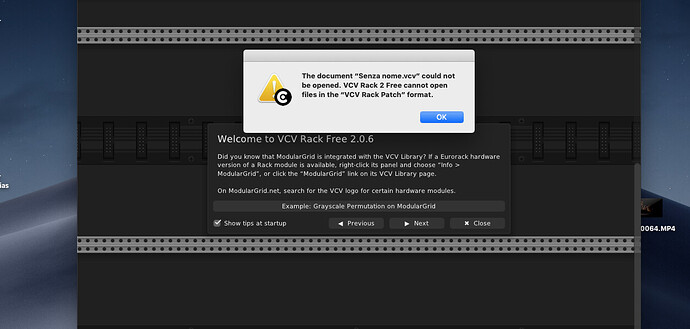

plus when I save a rack from Cardinal VST (inside Ableton) and try to open it in VCV Rack, this error message is returned.
that is normal. At least for now.
Do you mean that you don’t see the screenshot? If that’s the issue it is actually working and it was deployed. There’s only a problem with the screenshot - but if you test the sound it works. I was playing a bit with it yesterday and together with @falkTX we found that bug as well.
probably some compatibility issues due to modules, etc. I don’t think that for now you are supposed to be able to open the Cardinal generated patches on VCV

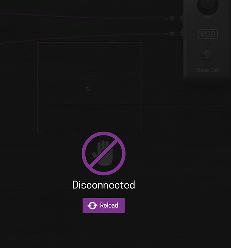

Hello.
Each time that I’m trying to load the module in Mod Duo it disconnects.
Mod Duo is updated to latest version.
I am on a Mac M1

The Duo build is fixed now.
Plugin category has been set to Utility.
I have downloaded the latest version on my Duo and it works now.
Thanks!
