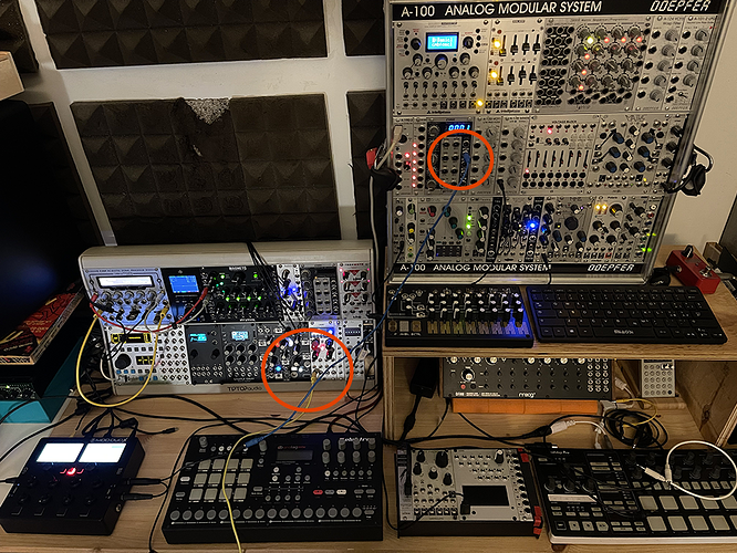

A very normal connection, they are two euro LFOs that enter the splitter to modulate the two parameters cv capture 1+ 2 inside de DUO

Regarding the splitter cable, are you sure it splits TRS to TS and RS (stereo to 2x mono so to say)? Some cables simply split TRS to 2x TRS, which would explain why you wont get any signal on CV in2. Something like this should work!
