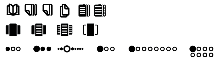

I think you misinterpreted the meaning of this icon. It is to indicate “pagination”. The 3 dots indicate 3 pages, the first of which is selected. There will be up to 8 pages available but it’s a bit excessive to have 8 dots on the icon. This icon is pretty common for indicating pages in mordern devices. Smart phone menus for example. I think it would be a bit strange to have an icon which shows where the button is on the device. Icon inception :grin:
We actually had a big discussion today before checking in here and have come to a pretty similar conclusion. Basically naming all 3 buttons means there won’t be some weird order like 3,1,2 if the pagination button is used as an assignable switch. It also allows room for changes in functionality down the road
Hi James, if even I don’t really understand the 3-dot icon, even though I deal with these things every day, you can assume that many others won’t understand it either. The three dots are simply too identical with the three buttons, so that the subconscious will make such a connection with many people here.

Luckily we don’t have to assume since we have data from the survey :wink: I can tell you that the majority of responses were correct, saying that the icon is for pages or at least that it cycles through 3 or more of something (pages, banks, presets etc)
In saying that there’s always room to improve
This is true. We have some other alternatives to try to differentiate it better
This could work for products in the DIY market but I don’t think it would be an appropriate design decision for this product. Also the idea that somebody has to essentially finish the product when it arrives kind of suggests that we failed to finish it ourselves :sweat_smile:
I’d be interested to hear if you had another idea for a “pages” icon which could be more easily recognised
Unfortunately I haven’t seen the survey. In order to be able to judge whether the consent of the participants is resilient, I would have to know what the question was. This should only be of real value if you asked freely what the three circles symbolize without giving any solution. Otherwise, the participants take the solution that is most likely for them. Even if they had never come up with the solution without this help. Unfortunately, UX-testing is a very complex affair :slight_smile: .

We also tried some other icons which are more “page” looking. Somebody posted some links earlier but I think they deleted the comment. Here are some that I made during internal testing
There are a few problems with these:
  1. The paper or book style icons can be misinterpreted as the “copy” or “paste” icon or some other function
  2. The button only cycles through pages in one mode of the device. A better, broader description of it’s function is that it scrolls/switches/cycles through pages or other things depending which mode or menu you are in so the more universal symbols like the 3 circles seemed more appropriate.
I think the issue highlighted by yourself and some survey responses, is that the circles, especially being 3, can be confused with the buttons or knobs in some cases. So moving forward we might try some variants with other shapes or numbers of shapes. Eg squares or 4 circles
It was like this with a few others too. Most likely you would confirm your first thought when you start using the device but it’s good to know that we can improve it so there will be less confusion
Regarding the “assignable control”, I’d consider using an asterisk (*) with a stroke width consistent with the other icons. Maybe it’s my programmer’s POV but I understand * as a sort of wildcard function.
